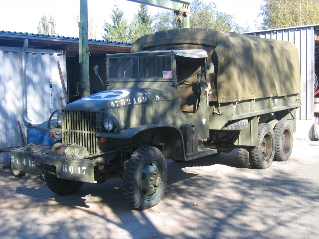

Hello all,
Catman...Thanks for the great explanation and pictures. I always wondered if the bed on my truck was original or a post-war replacement. The truck was produced in April 1944 and was a "European return" from the Army of the Netherlands in 2003. Since it had an identical bed to every picture I had seen I assumed it was the original bed. BUT, the explanation of the machined half moon drains on the stake pockets mean my bed too is a post-war produced bed
. Interestingly only the middle three stake pockets have the half-moon cutouts and the two end ones are still solid. I've learned something new about my truck!! Thanks again.

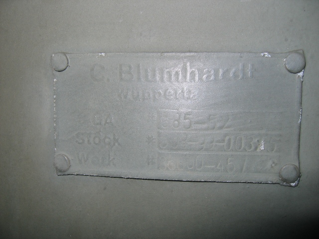

Chris_M......Where is the data plate on your bed detailing the firm that produced your bed. When we removed my bed during the restoration I didn't see any plate but I'll look again for maybe a missed plate or holes where it once was.
I took a drive in my truck last weekend...Hopefully my first attempt to load pictures is successful. Thanks again!!

Chris_M
Thanks for the info and picture on the replacement bed data plate. I went out and checked mine and sure enough have no data plate nor holes where one was once. Thanks for going to the trouble to get the pictures.

The forged type tie down hooks are what are on my all steel bed. That means it's a WWII production bed. It does have the half-moon cutouts on the center three stake pockets but not the end ones. So, could it be the bed on my truck is an an original early WWII one placed on this April 1944 chassis in some post-war rebuild program? If these trucks could only talk! The tales they could tell.
Thanks for all your help.
