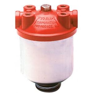

Look at the Fram HPG1 Filter assembly - Summit Racing sells them and the replacement elements. Same style as the WWII edge type filter and housing.
They sell for under $45 US. I put one on our Dodge and am pleased.

Jeff,
Is this the one?

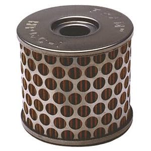

Did you get it with this insert?
A good alternative with close to the original look (after some paint).

I use a NAPA 3042. It fits in the original filter bowl and works perfectly.

Re: Modern fuel filter element?
THat is the Fram replacement filter assembly. The NAPA number that Nick listed for the original bowl works great too, if your CCKW still has the original.
Here is the new made Fram components on the Dodge WC firewall
