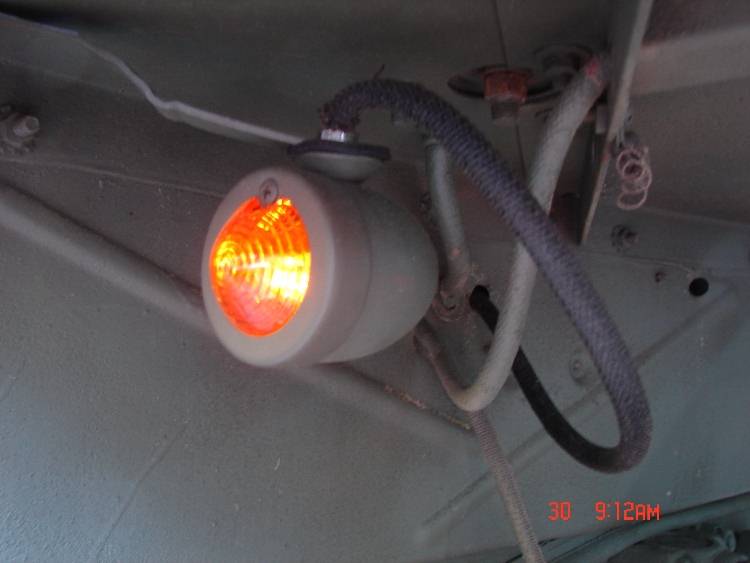

It is not as extensive as John has accomplished. I replace the right rear taillight (blackout bulbs only) with a left rear asssembly complete. It gives me normal running lights all the time. I then added motor cycle front signals to the diagonal front fender support. (It is tucked far enough up under the fender so it is barely noticeable) I painted the housings OD. I then added a column switch also painted OD.
I live in a heavily traveled tourist area full of "flatlanders" on weekends. Some of the worst drivers in the US. They now can't say "but he didn't have any signals". Never mind that it is a huge CCKW, or a Chevy Fire Truck, or an Ambulance with a Big Red Cross on the Rear.

Below is a picture of one on my Dodge Ambulance. The mount is different than the GM products.
