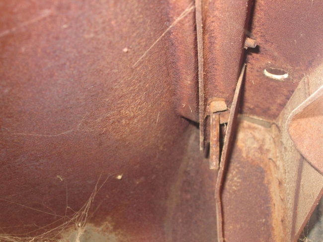

A shot of the rubber insulator that sits between the door frame and outer skin
This is the window track with the deteriorated track material inside. I haven't figured out where to source that yet, and the typical Chevy parts sites don't seem to have it. Or if they do, it's not easy to locate on their web sites.

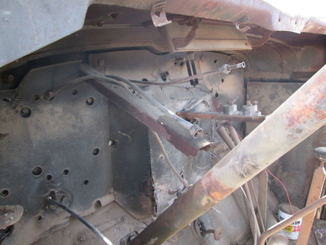

My dirty mess of an engine compartment. Thankfully most of the firewall components can be easily removed. I'm debating on pulling the engine, since I plan to install new engine mounts. I just dread having to pull the transmission and work on the drive line, even though they need a thorough cleaning and degreasing.
Last I check, my engine is a 1955 235. I'm not sure if the crank sits low on these engines, or if the front engine mount is a bubba special that sits too short. But the way it sits now, I can't use the hand crank.
Got the main floor panel out for restoration. This is the only part that needs welding to fix the slot made by the P.O. for the power takeoff lever.
An inside view of my firewall after removing the padding. I wish I would have bought a repro firewall pad set from John when he was making them. I can't seem to find the correct black fiberboard in big enough sheets to cut my own.
