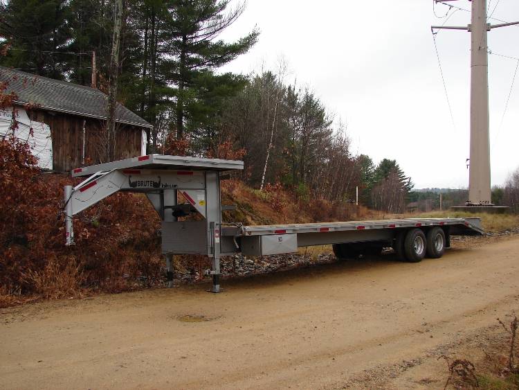

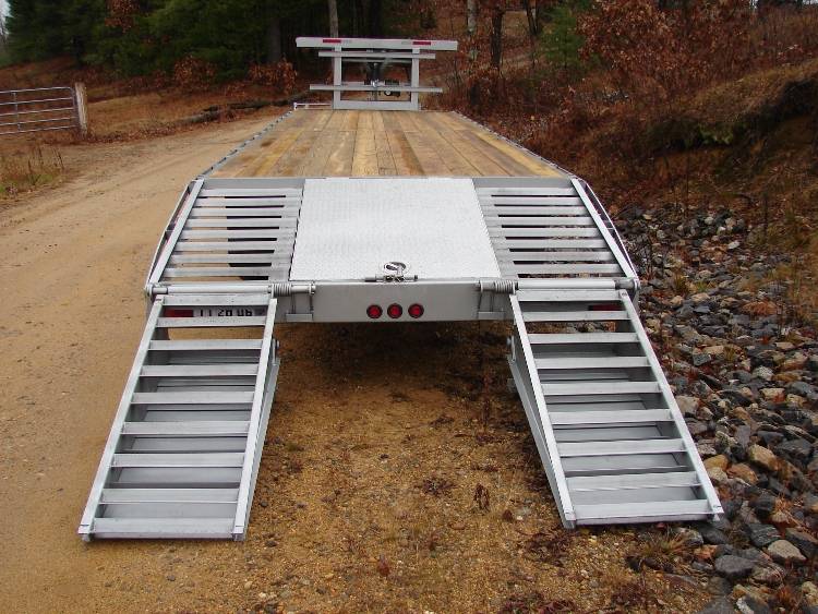

I have this same issue.
I am at then northern end of most of our club events. At 35mph it is 2 hours 1 way to get to most stuff in a hot noisey truck.
So to carry my 1.5 ton Fire Truck and CCKW I bought a 1 ton dually and a 32 foot goosneck trailer.
I did so because I found that towing a 10,000 pound truck on a trailer that weighs 4-6K pounds puts it over the specifications of what any 1/2 or 3/4 ton pickup can tow.
I bought a 27 + 5 24,999 lbs gooseneck. 8 tires on the ground with ramps.
Nice rig and well balanced.
It will have it's initial recovery operation this coming weekend by going to get the beautiful Marine Corps CCKW that Dr. Deuce is going to chop up and part out.

It was not inexpensive...but...it did extend the travel range of my Chevy Fire truck and CCKW to anywhere in the US and Canada. I venture it was worth it.abn duce wrote:Thats a sweet trailer ! and it all went well according to the other thread. I d hate to ask what the package set you back suffice it to say that what ever the cost the outfit does its job well.
I have discussed this before. I am at the northern edge of where the club activites are. At 35 mph you can't go very far in a WWII vehicle. That puts me a minimum of 1.5 hours from where it is all happening.
