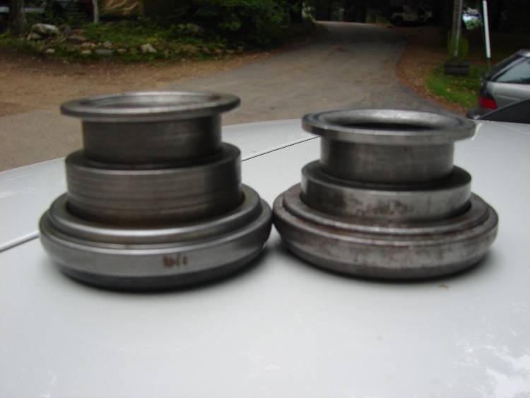

I thought I had a source for the TOB on my CCKW.
GMC PN is 2140122. The part number is no longer in the GM system. Checked with Frank and Army Cars with no success. GMC Medium duty dealer looking at parts book gave me PN 909422. Which is the same as listed for a Chevy pre 50.

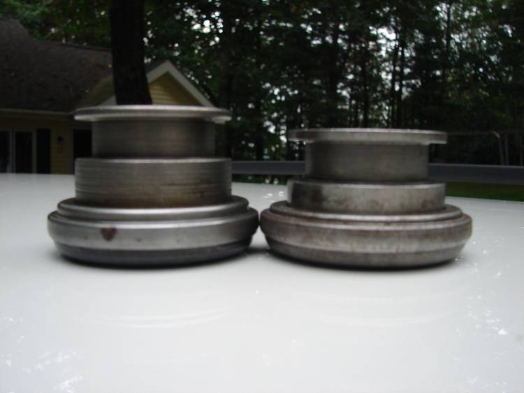

The part arrived and it is 3/8 of an inch taller than the one that came out.
FYI...the truck was rebuilt once in the states and then again at least once in Norway where the clutch was replaced. I know this because the design of the disk is different and the pilot bearing has Sweden on it.
Anyone know a source for a CCKW TOB, and/or the part number. Would also like to know the correct height of the whole bearing. A cross reference would be a big help.
Thanks,
TOB on the right is the original...on the left is 909422 genuine GM New Departure.

So which is the correct one? The short or long one?
The part ordered under the original number arrived today and it is the same dimensions as the part that was removed.dr deuce wrote:So which is the correct one? The short or long one?
For future reference the numbers stamped on the release fork side of the bearing are:
Aetna Bearing Company
A-2765
US PAT. NO.2403460
MADE IN USA

The throw out bearing I just took out of my CCKW is the shorter one as picture above. The new one I ordered using the numbers above is the taller one. Can I use the taller one? The previous posts are not clear to me. Thank you in advance. Paul

The longer bearing in the above picture IS CORRECT for the GMC 270 engine as used in the CCW, CCKW and DUKW. The shorter bearing at the right is correct for Chev cars and trucks of the 40's with the 216, 228 and 235 engines...including the G-506 trucks.
